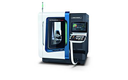

With a new look and improved performance across the board the new 2nd generation ULTRASONIC 20 linear impresses in demanding ultrasonic machining.
The decisive technological innovations of the ULTRASONIC 20 linear 2nd generation include a new, completely digitally controlled ultrasonic generator plus ULTRASONIC actuators with enhanced performance.
With the ULTRASONIC technology developed in collaboration with SAUER, DMG MORI has for many years now been offering high-performance machine tools for the high-precision 5-axis machining of complex workpieces made of advanced materials. The series has now entered a new league with the new 2nd generation ULTRASONIC 20 linear. Extensive optimizations across the board, from the expanded ULTRASONIC technology and the machine construction, the performance and on to include the options available, further enhance the technical edge of the machining center. Spindle speeds of optionally up to 60,000 rpm, more powerful drive motors, an even smaller footprint plus CELOS with apps developed specifically for ULTRASONIC are among the innovations that users from the optical, clock and watch, medical and high-precision mold construction sectors will benefit in future.

The decisive technological innovations of the 2nd generation ULTRASONIC 20 linear include a new, completely digitally controlled ultrasonic generator plus ULTRASONIC actuators with enhanced performance. The tool holders with adapted actuator technology are changed into the milling spindle simply and automatically. Each of these holders contains so-called piezo elements, which are activated by a program-controlled inductive system with a high frequency of between 20 and 50 kHz. The actual tool rotation is thus superimposed with an additional tool movement in the longitudinal direction so that a defined amplitude, which can be programed in the NC-program, in the range of up to more than 10 µm is generated on the cutting edge of the tool or on the grinding layer. During grinding, drilling and milling this ULTRASONIC superimposition of vibrations has a direct, positive impact on process forces, metal removal performance and tool service life and thus on the machining result in the form of cost efficiency and accuracy.

The smartSONIC is used in the 2nd generation ULTRASONIC 20 linear as a new ULTRASONIC generator. This automatically recognizes the ULTRASONIC frequency that is best suited for actuator and tool. As another world first it also tracks the frequency and amplitude power during the machining process. To achieve this the smartSONIC automatically tracks the frequency response and compensates all external impacts, such as damping of the ULTRASONIC vibrations caused by the prevailing process forces. This results in consistent control of the set amplitude or that defined in the NC-program. So the user can maximize his process to the utmost and thus increase tool utilization, minimize cycle times and most especially achieve even more filigree, accurate and high-quality manufacturing results thanks to the reduction of process forces.
DMG MORI relies on the long-term stable gantry design for the 2nd generation ULTRASONIC 20 linear in order to meet the demands on precision for ultrasonic machining. Whereby the machine tool manufacturer was able to reduce the footprint to a compact 37.7 ft². A duel drive in the Y-axis and the integral cooling concept that includes temperature monitoring of drives and spindles as well as the control cabinet and all media guarantee top precision and component accuracy. The linear scales from Magnescale are another example of the high-tech components used by DMG MORI here.

After its revision the 2nd generation ULTRASONIC 20 linear is now also capable of handling larger tool diameters of up to ø 2.0 in. It has also been possible to increase the workpiece weight from 22 lbs to 33 lbs. The basic machine is equipped in the standard version with a powerful 19 kW motor spindle, HSK-32 tool holder and 42,000 rpm. Higher speed requirements are met with an optional spindle that offers an impressive 60,000 rpm. An HSK-40 spindle, optionally with permanent grease lubrication, rounds off the offer in this segment.
DMG MORI’s modular concept allows very application-specific equipping of its machines, also in the case of the 2nd generation ULTRASONIC 20 linear. The machine is also available with a 1,500 rpm mill-turn table, for example, which expands complete machining to include milling, turning and grinding of rotational-symmetrical components in a single setup. In addition to the standard 24-fold tool changer with pick-up, the chain magazine is optionally available for 60 tools.

High-quality, long-lasting covers as an external feature and functional added value thanks to optimum accessibility are the key properties of the new DMG MORI joint design. The 2nd generation ULTRASONIC 20 linear also appears in this new look, thus lending the machine a high level of value retention. It is also equipped with CELOS. This uniform user interface with its unique multi-touch screen is as simple to operate as a smartphone. This user-friendliness is further boosted by CELOS apps developed specifically for ultrasonic machining, which visualise ULTRASONIC technology cycles and key process parameters such as frequency, amplitude and output. These apps also monitor the process forces of the actuator and aid setting up of the tools.
