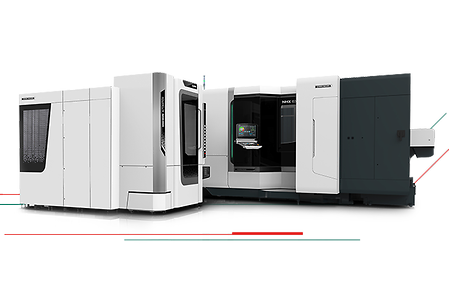

CPP (6 stations) with NHX6300
  • 1 layer pallet pool solution in multiple possible setups for automated, unmanned operation fit to customer facility:
    • straight line arrangement (S) or right-angle arrangement (R)
    • Up to 29 pallets and 2 work setup stations / up to 4 machining center (on request)
  • Easy operation using machine controller of machine center with Pallet Manager
  • Optionally DMG MORI´s own cell controller “MCC LPS III” available
  • MCC LPS III is added from 2nd machine in one CPP by default
  • Space saving, automation at low cost
  • Combination with various kinds of options
