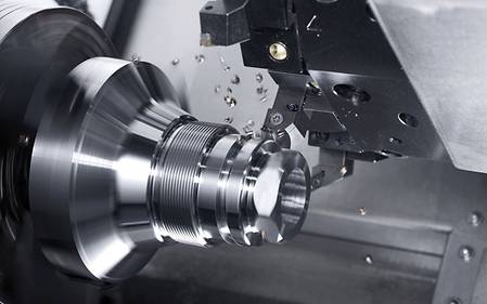

Integrated spindle drive with 3,000 rpm, 37 kW and 790 Nm
- Integrated and liquid-cooled spindle motor for maximum temperature stability
- Better accuracy of the C-axis by 0.001 ° resolution
12 station VDI 40 turret with up to 12 driven tools
- Servo-controlled turret for maximum functional safety
- Up to 6 driven tools for machining complex workpieces
- Driven tools with 4,000 rpm, 7.5 kW and 36 Nm of torque
