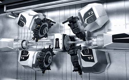

NZ QUATTRO
Four turrets with four 80 mm Y-axes and up to four B-axes.
Turning Performance
- turnMASTER main and counter spindle with up to 7,000 rpm (5,000 rpm as standard) and 174 Nm (100 % DC)
- 8 mm cutting radial depth at all 4 turret positions in CK 45 (65 mm cutting diameter // 270 m/min cutting speed // 750 cm3/min metal removal rate)
- 36 month warranty with unlimited spindle hours
Milling Performance
- 12,000 rpm built-in motor turret with up to 24 Nm / 16 kW
- 12 stations for VDI 30 and BMT 40 or 16 stations for VDI 25 and BMT 45
B-axis
- At all 4 positions possible
- -10°– +100° swivel range
- Standard tools instead of special angle tools & 5-axis simultaneous operation possible
- Tool Management System
