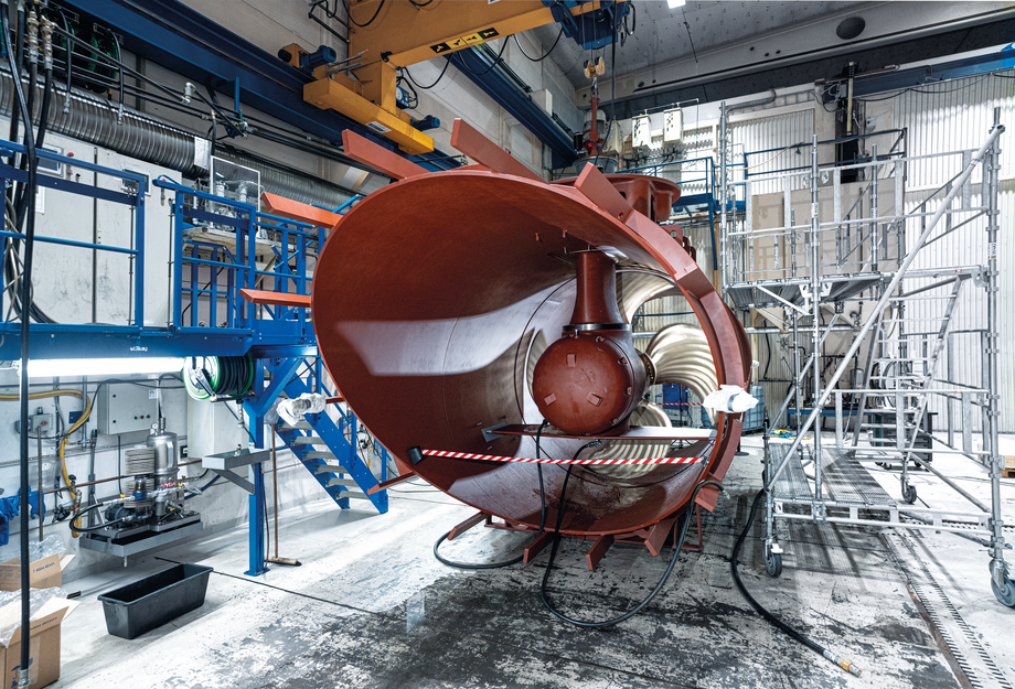

As early as the beginning of the 20th century, Brunvoll Motorfabrik, which was founded at that time, produced the first diesel engines and propellers for fishing vessels. Based on an idea of the Gjendemsjø brothers, two local fishermen, the company began developing and manufacturing tunnel thrusters in 1964 – still a common principle of marine propulsion.

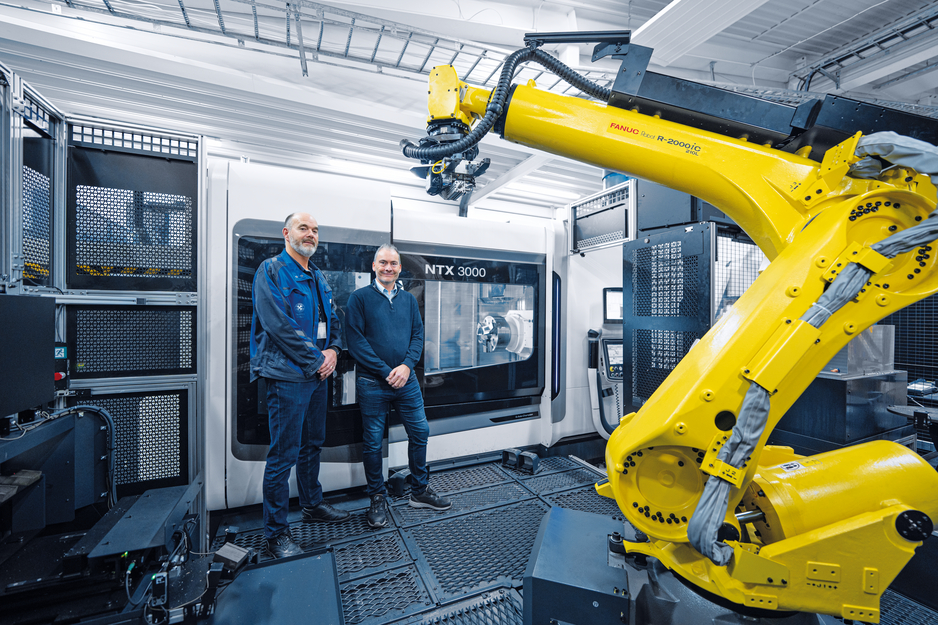

The machine tool manufacturer’s automation solution is based on the modular MATRIS system and includes an NTX 3000, a conveyor system for Euro pallets and a FANUC robot with automatic change of grippers. Seven can be accommodated in the cell. With the aid of a 3D vision system, the robot picks up workpieces from the Euro pallets and transfers them into the machine. An interim storage station allows the robot to grip the workpieces. Finished parts are removed, cleaned in a wash station and then replaced on the pallets. “Depending on the size of the components, we can load the workpieces on the pallets in several tiers using intermediate wooden shelves. In this case, the robot also handles the shelves,” says Kjetil Hoem. The entire process is controlled by the userfriendly MAPPS controller. The whole system is also prepared for automated guided vehicles (AGVs), which Brunvoll plans to use in future for the supply and removal of the pallets.
NTX 3000: High-performance turn-mill machining with 130 Nm spindle
Brunvoll chose the NTX 3000 to machine workpieces having diameters of 45 to 400 mm. The maximum length of the parts, which weigh up to 120 kg, is 400 mm. The versatile turn-mill center even ensures 6-sided complete machining of complex components. In addition, milling operations are possible, comparable to those on a machining center, thanks to the powerful compactMASTER turn-mill spindle with over 130 Nm of torque. The tools used are equipped with a Balluff chip, so that the correct tool data can be read into the machine at any time.

The extremely diverse workpieces also require extremely diverse workholding . “With this manufacturing solution, it was essential that the robot could also change the chuck jaws”, said Magne Gøran Lyngstad describing one of the challenges. For this purpose, DMG MORI equipped it with a special gripper and integrated a rack system in the cell with space for 60 sets of three jaws. The robot can handle the jaws into the robotic cell via a feed area and either store them or use them immediately. The clamping system developed by DMQP (DMG MORI Qualified Products) partner Schunk is designed explicitly for such automatic changeover. The jaws, as well as the gripper hands and pallets, are identified by an RFID system to ensure absolute process reliability. The reason Brunvoll commissioned DMG MORI to design and install the automation solution was partly because everything came from a single source – with one contact person who coordinated everything. The competitive price was another key factor. A team in Japan was responsible for the design of the manufacturing solution. “We also carried out the preliminary acceptance there in order to be able to make any subsequent improvements easily,” recalls Kjetil Hoem. The automated NTX 3000 has been operating extremely reliably since its final installation in Molde.
