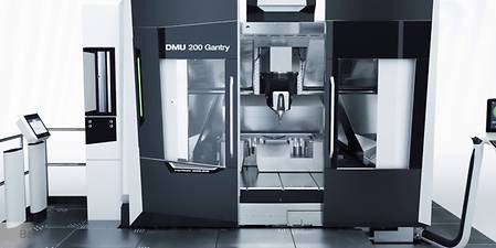

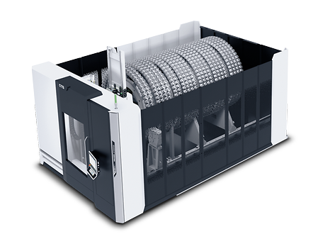

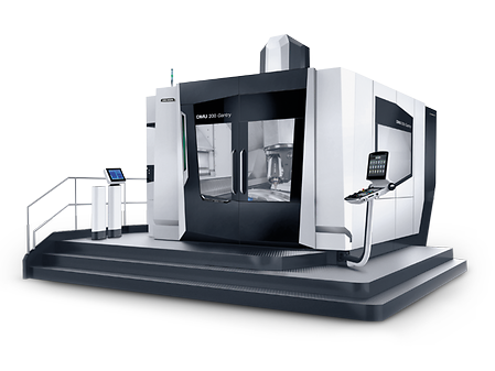

DMU 200 Gantry
Dynamic Gantry design machine for the machining of large workpieces
Flexibility through spindle versions
- 45° head and 90° head for 5-axes machining up to 20,000 rpm
- Ready for new technologies like Ultrasonic, Laser or machining of carbon material
Working area concept
- Fixed table 2,250 x 2,000 mm with 10,000 kg loading capacity
- T-slots across the table for easy chip removal
- Chip conveyors on both sides of the table
Low Gantry Design
- 50 m/min rapid traverse
- Best visibility into the working area through missing side walls
- Maximum utilisation of the working area
- Modularly expandable in the X-axis up to 4,000 mm
- Machining of workpieces up to 20 t (with X-axis option 4,000 mm

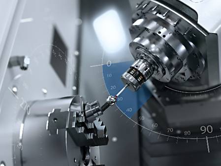

5-axes machining
- 45° head with 90° swivel range and +/- 300° rotating range
- compactMASTER spindle with 20,000 rpm
- 90° head with +/- 120° swivel range and +/- 300° rotating range
- compactMASTER spindel with 20,000 rpm
- Optimized PLC cycle times
- Familiar look & feel
